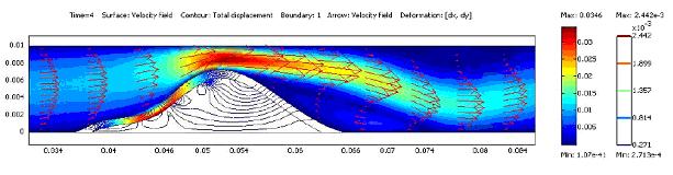

I was trying to simulate a FSI problem by modifying the COMSOL FSI example, trying to see the same effect presented in the following reference:
Zhiyong Li, Simulation of the Interaction between Blood Flow and Atherosclerotic Plaque, Proceedings of the 29th Annual International Conference of the IEEE EMBS Cité Internationale, Lyon, France, August 23-26, 2007.
It creates a plaque with cap and core of different Young's moduli, and computes the interaction of them with the blood flow. The model is shown in the attached picture.
