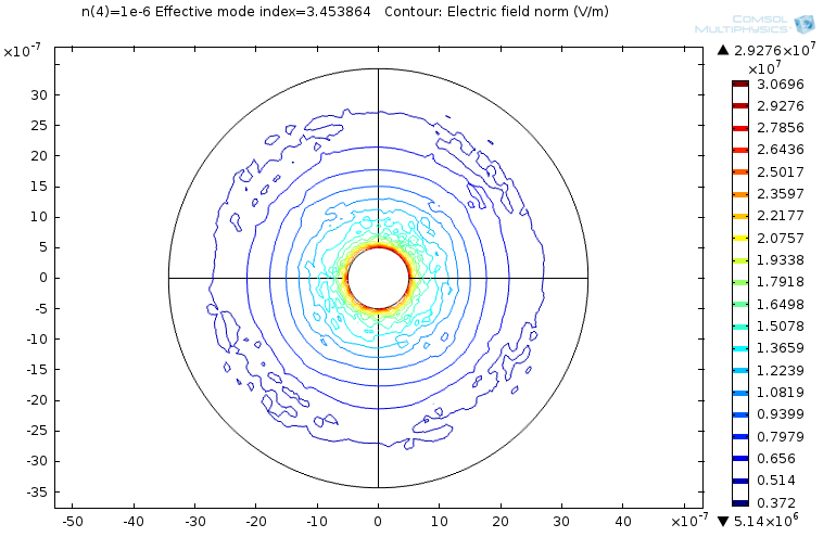

Could you suggest to make dimensionless. I am using 1 GHz as frequency which means 0.3m would be the wavelength. Now as I am going smaller and smaller it should be much smaller to the wavelength.
Regarding the meshing, i have even tried "Extremely Fine" as Element Size and Refine as 2 to increase the number of elements, still the same issue exist for the um(10^-6) ranged coaxial cable.
The inner cable is of radius 0.5*n and outer one as 3.5*n where n = 10^-6.

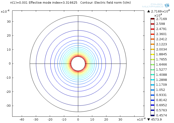

I am using the Physics as "Electromagnetic Waves, Frequency Domain" and "Mode Analysis" as Preliminary Study.
The standard equation which is solved is wave equation:
delX (mu_r^ -1 )(del X E) - k^2(epi_r - j sigma/( omega*epio) E = 0
But the real issue which I am facing is that for a particular combination of dimension of waveguide and frequency of operation I am not getting field patterns similar to theoretical ones.
Outer Radius = 3.43*n
Inner Radius = 0.5*n
Dielectric Constant of material is 11
Conductors are Perfect Electric Conductors.
Till now if for two cases I am seeing discrepancy:
1. Waveguide is of the order of um( n = 10^-6) and Frequency = 1 GHz
2. Waveguide is of the order of mm( n = 10^-3) and frequency = 1 MHz
The ratio of dimension vs wavelength is same in both cases. I am not sure which limitations am I hitting ?
