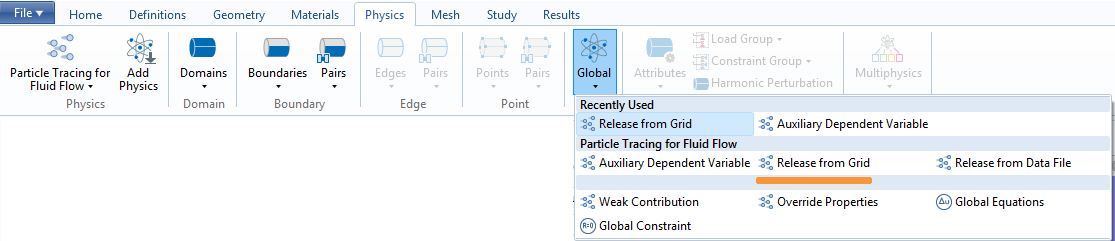

Hi Sepideh,
you can use the "release from grid" node to specify the release of particles on specific locations (found under global conditions).

Hi Sepideh, you can use the "release from grid" node to specify the release of particles on specific locations (found under global conditions). Best regards, Frank
