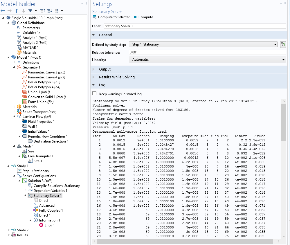

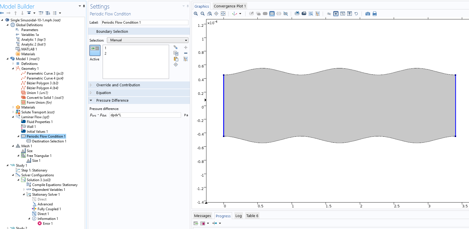

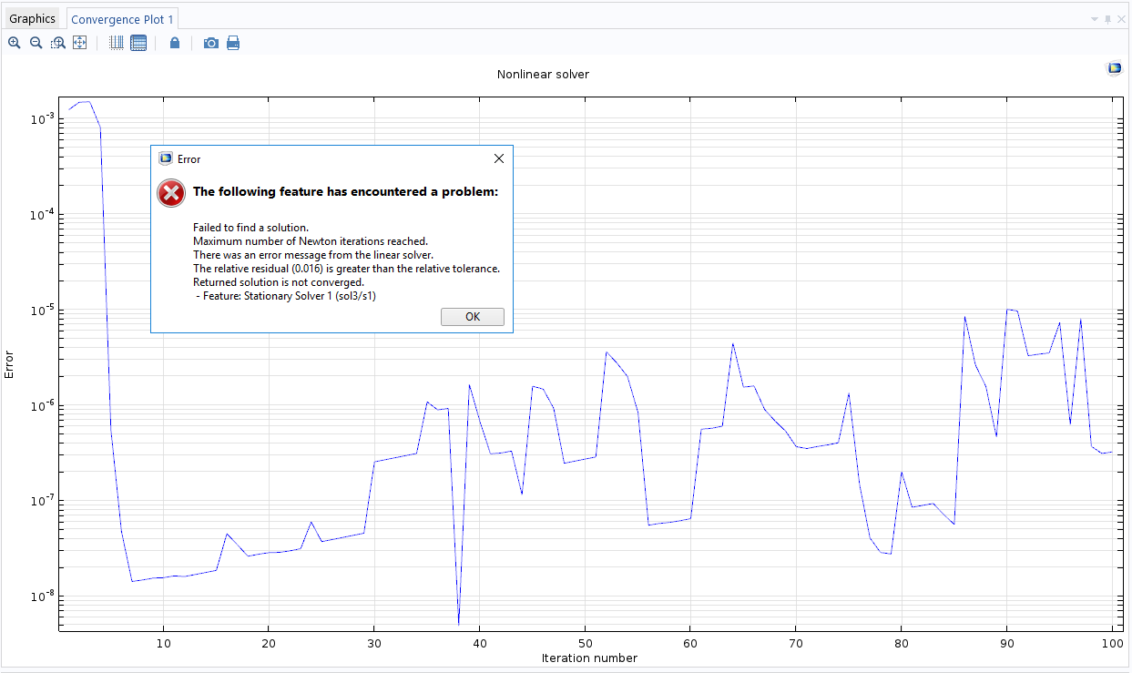

Posted: 8 years ago Feb 22, 2017, 3:23 p.m. EST
Hi Jeff,
Thank you so much for the answering. I attach three pictures which you can have a closer look at the problem I am encountering. Picture 1 shows the model and periodic flow boundary, and Picture 2 shows the Solver Configuration where you can see, I just adopt the default settings and the relative tolerance is 0.001. Picture 3 shows the Converge plot, as you can see the Error is really tiny. But I do not know why the calculation is not stopped when the Error is below 0.001.
I am trying to upload the mph file, so you can see it directly.
Hi Jeff, Thank you so much for the answering. I attach three pictures which you can have a closer look at the problem I am encountering. Picture 1 shows the model and periodic flow boundary, and Picture 2 shows the Solver Configuration where you can see, I just adopt the default settings and the relative tolerance is 0.001. Picture 3 shows the Converge plot, as you can see the Error is really tiny. But I do not know why the calculation is not stopped when the Error is below 0.001. I am trying to upload the mph file, so you can see it directly.

Dear Jeff,
I solve it according to your comments, thank you so much.
I have not got your meaning until I have a try.
Thank you again, it really helps.
Jiaqing
