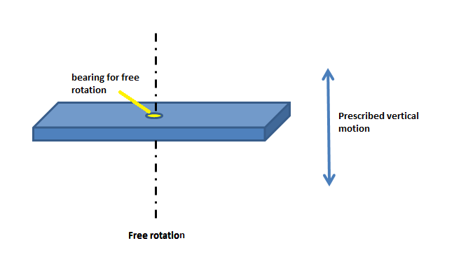

May I ask someone to advise me how would I model a rectangual plate with prescribed vertical translational motion capable of free rotation along horizontal plane.
Plz see the image attached.

I see a few ways but it depends on what else you want to do and the surrounding of your model:
If we consider ONLY the plate as is, one can
a) put oneself in the "rotating" reference plane and apply "roller" conditions to the 4 edges,
Any centrifugal forces can be applied by adding a body load in cylindrical coordinates, but one needs an equation for the rotating velocity
b) if the model accepts that the side edges are perfectly RIGID (but really 100% rigid, and with no thermal expansion ... still a valid assumption) then you could joins all side edges with a "Rigid Domain" BC and constrain the X,Y displacements of the CoR, and leave the Z and Theta free
c) if the centre of the plate is on a shaft with ball bearings with a cylindrical hole, one can constrain that cylinder wall with a "roller" BC
The latter is probably easier to combine with other physics

Actually this assembly is vibrating up and down sinoidally in fluid and allowed to rotate freely.
I am trying with 3d FSI hope the option c) seems to be more suitable.
