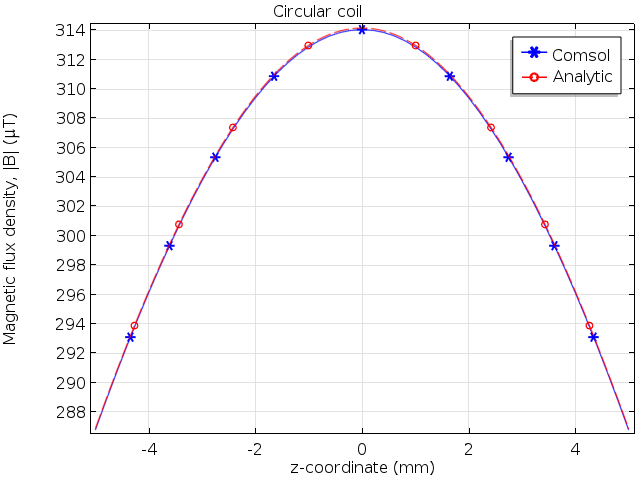

Attached is model file with comparison to analytic solution.
Sergei

Attached is verification model in v.4.3.
Sergei
