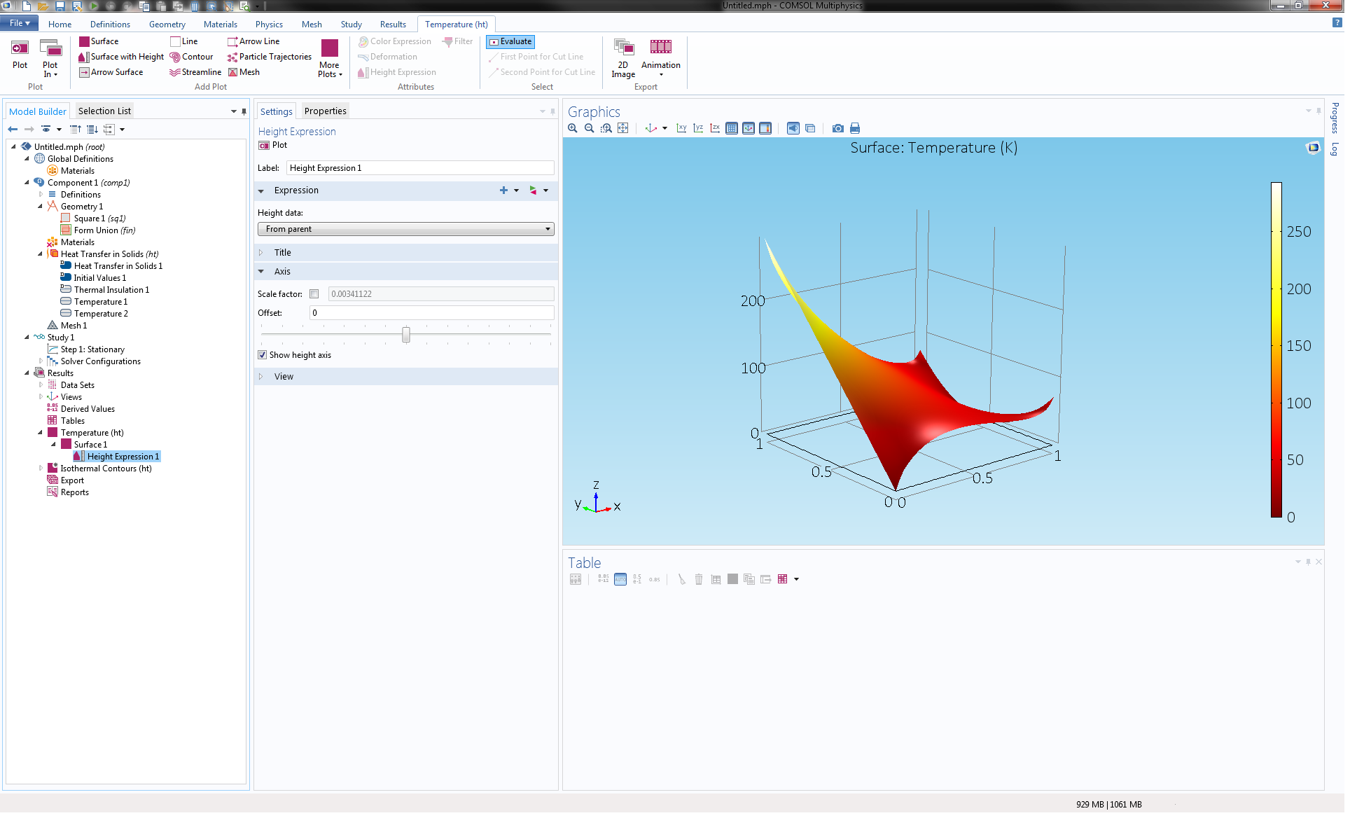

Is it possible to plot a 3D graph in COMSOL using x, y, T as axes? T being the temperature

Are you thinking of a graph where the value of T is represented as a surface whose elevation depends on x and y?
If so, you can do that using a "Height Expression" node, see attached screenshot.
