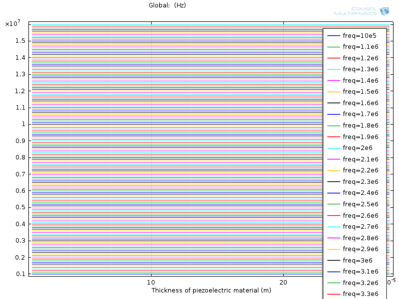

Hi!
I have trouble finding the location of a maximum. I have a parametric sweep over different thicknesses of a piezoelectric material and I want to find the frequency at which the pressure amplitude is at its peak value. I want to plot is so that the frequency at the peak value is on the y-axis and the thickness of the piezoelectric material is on the x-axis. I tried using maxop1(pzd.pm, freq) but when I do that I get the graph which is attached. Can someone please help me?
best regards
Antonia
