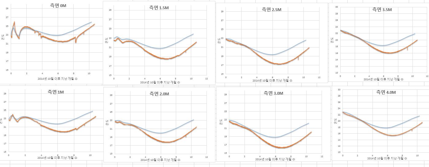

My goal is to compare numerical analysis results with field test results which are both time-dependent.

Regarding the results, the time range is about 10 months, starting from winter to summer. When i compare the results with field test data, both results were almost close at the very beginning up to 4 months but it starts to have a big temperature difference after 4 months which the weather (out temperature) starts to increase. ( the difference is up to 2~2.5 celcius).
And when i plot a graph, it seems like there is a bit time lag in my model and i cannot find exactly what the reasons are.
Will you guys please find why it happens ?
