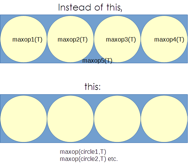

- I have an assembly consisting of an array of circles in a rectangular matrix (please see picture).
- I have a Heat Transfer Physics and I need to define a global ODE. The ODE should read the maximum temperature of a single domain (whether circles or rectangle)
- I would like to set a maximum operator for the entire assembly (including the circles and the rectangle domains)
- In the ODE, I would like to read the maximum temperature of a single domain, but using the maximum operator for the entire assembly.
- It is possible to "split" the maximum operator in different domains? Something like maxop(circle1.T), maxop(circle2.T), maxop(rectangle,T) etc., maxop being the overall operator.
That is, I would like to have the option to read the maximum temperature on each domain, without the need of creating multiple operators?

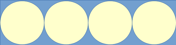

I have added another picture to describe my question. I hope this helps!

Hello Paul,
You could use a boolean expression in your integrand, something like
maxop(u*(dom==1))
to compute the max on domain 1, etc.

Thank you very much for the answer. I have tried this command with the temperature:
maxop1(T*(dom==1))
but I get 0 [K]. I have also tried to input dom==6 (I only have 5 domains) and it gives the same results. Any idea what am I doing wrong?
Paul

Oh, I have just realized that because of the way the geometry is built, the assembly is split in even more domains. But still, if I plot dom==1, I have 0 [K], which is weird.

Oh, I had the selection of the maximum operator only on the circles. Now it works! Thank you very much, Jeff! You have saved me hours of time spent for setting different formulae and operators.
[QUOTE] Hard to say without seeing your file. Please post it if possible. Jeff PS: That it returns 0 with dom==6 makes sense since the boolean expression is false and therefore evaluates to zero. [/QUOTE] Oh, I had the selection of the maximum operator only on the circles. Now it works! Thank you very much, Jeff! You have saved me hours of time spent for setting different formulae and operators.
