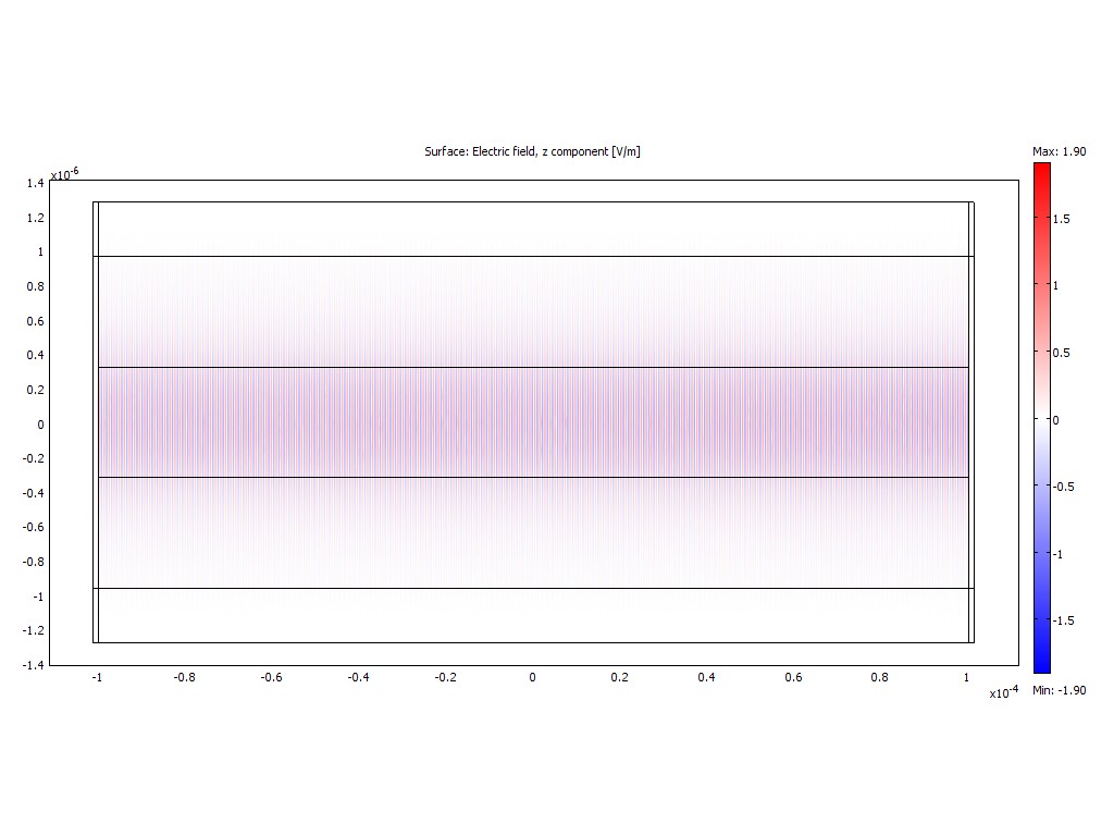

I'm attempting to simulate a simple slab waveguide (see attached). The waveguide has a core of n=1.5 surrounded by air (n=1) above and below. This design is surrounded by PML rectangles.
The boundary conditions and the size of the core are selected to be such that the electric field imposed on the three left boundaries (inside, to the right the PML, top to bottom) is a mode supported by the waveguide:
exp(-p0*y)
exp(-p0*d)*cos(h0*y)/cos(h0*d)
exp(p0*y)
The physics is based on the RF Module / photonic crystal model library in Comsol 3.5a.
I would like to know the core power input (left) and output (right). To this end, I have two questions:
1. I would like to take the core (middle subdomain), integrate the y-values and get a vector of the average power in each x value of the core. According to this vector I'd like to generate a graph of the decline of power from input to output as a function of propagation length x. Is this possible in Comsol?
2. I select the core input, and from Post Processing I choose "Power outflow, time average" (nPoav_rfwe), which seems a reasonable choice, but the results don't make sense to me (the input power -6.793381e-11 [W/m] is lower than the output -3.18875e-10 [W/m]; also, what do the signs mean? how can I simulate "time average" when the simulation is not time-dependent?). I would appreciate suggestions on how to measure the input and output power.
I'm attaching the model if anyone's interested.
Thanks in advance!

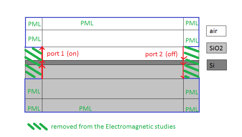

It took me some time to solve the problem, but now I think I have it running correctly as I wanted.
I will list the things that I did below in points, so that it's easier to follow.
Let's assume we work with a SOI waveguide of the following structure: SiO2 (bottom), Si (middle), air (top) - our model is a SIDE VIEW of the wavegiude, where the light enters from the left and leaves at the right.
1. Surround the wavegiude with appx. 1-2[um] PML layer all around.
2. Break the future port boundaries, let's say 1[um] below and 1[um] above the core, where you can assume there is almost no field.
3. Get two Boundary Mode Analysis nodes and one Frequency Domain under study. Make sure the Boundaries are calculated first.
4. Make the ports at the inner circumference of your model (outer will have your power eaten due to neighbouring PMLs).
5. Each port should be composed of three segments. Set excitation to port 1. Set 'numeric' to both.
6. In the Boundary Mode Analysis nodes, set port 1 (and 2, respectively), the refractive index as you expect it to be (whether this will give you TE, TM or higher order modes you should know in advance), number of modes eq. to 1 and the frequency you are interested in. (Lu Ding is right, if you want to account for dispersion you need to make a frequency sweep).
7. Very inportant. Remove the domains that exist between the ports' segments and the outer boundaries of your model from the Electromagnetic Study. This will automatically break the PMLs just behind the ports. If you fail to do it, some part of your power will be absorbed behind the ports giving your S-parameters no meaning at all.
8. Send wishes that there will be no errors...
I think that's it. Ai least it worked in my case. Of course, you can extand this model to anything you want, but it should work whenever you want to excite the fields at the ends of a dielectric 'sandwitch'.
Good Luck

From your description, your model is built in 2D plane with cross section view, assuming the SOI waveguide as a infinite wide slab. And you use the effective index instead of the bulk index. Am I correct?
By just reading your tips, I am still a bit confused about where the PML and ports are. Would you mind to upload a simple geometry graph for me to understand better?
Best
Again, it took me too long. I am sorry.
Answering you rquestions:
n_air = 1.00
n_SiO2 = 1.44
n_Si = 3.47
you assign them to the materials.
Then, you use the 'Boundary Mode Analysis' nodes, both linked to the specific ports, to figure out what kinds of modes the ports should excite or absorb on the 'Frequency Domain' study. In general N ports require N 'Boundary M.A.' nodes. ports are recognised by their index (1,2,3,...) and modes by their effective index of refraction. I recommend you to allow only one mode. You do it by specifying number of solutions equal to one and a relevant quess on the expected index of refraction a priori.
The result will be that you get a (transverse) mode to propagate, having some effective index, that will be n_cladding < n_eff < n_core.
If you want to account for the dispersion, you should probably parametrise the material indices somehow. (I haven't ried yet). Or as you say, try to make a time domain simulation (I also haven't tried).
You can find and attached drawing of where to assign which property. It is important that you exclude the area from behind the ports from the studies.
Good luck!
