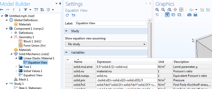

solid.pm is the 'pressure', that is -trace(Cauchy_stress_tensor)/3 .
If you want to see the exact definition of a variable, go into Equation View. See the attached screenshot.
