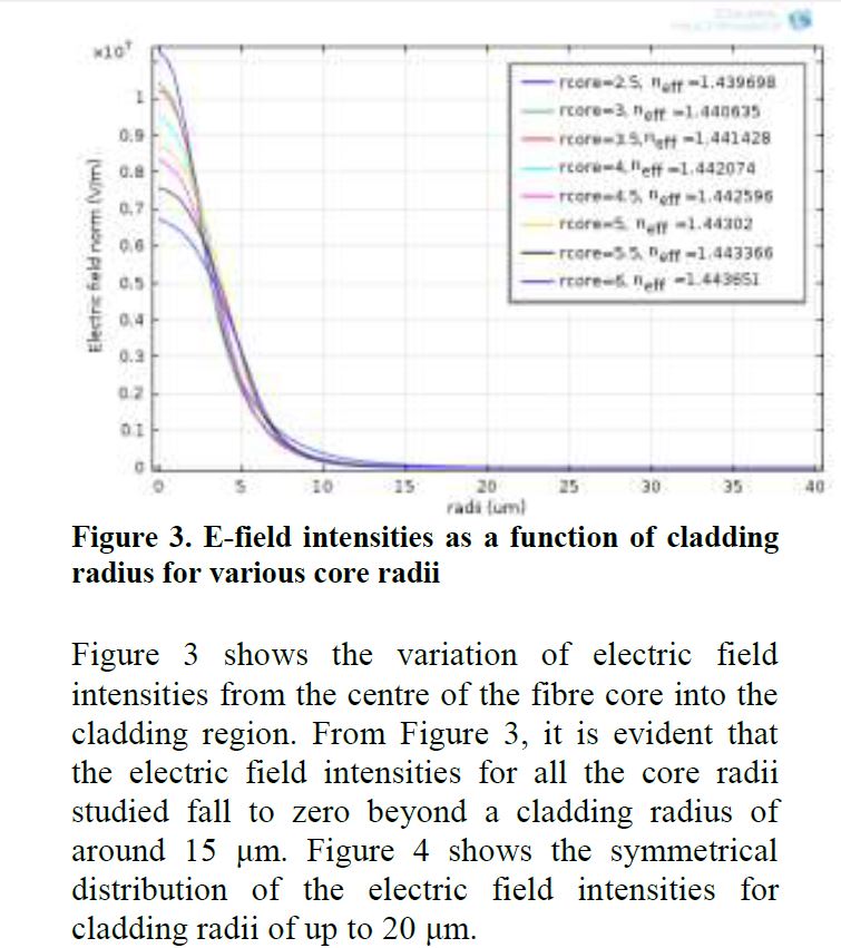

Posted: 9 years ago Jun 27, 2016, 8:31 a.m. EDT
Hello Dear,
Please if you can have a look over the attached snapshot. the attached image is for a graph made by comsol but I can't figure it out.
Thank you all ways!
Hello Dear, Please if you can have a look over the attached snapshot. the attached image is for a graph made by comsol but I can't figure it out. Thank you all ways!
Jeff Hiller COMSOL Employee
Posted: 9 years ago Jun 27, 2016, 8:43 a.m. EDT
Hello Walaa,
I am not sure why you don't think you can do a parametric sweep. The software does allow you to sweep two (or more) parameters at the same time. See attached toy example.
Best,
Jeff
