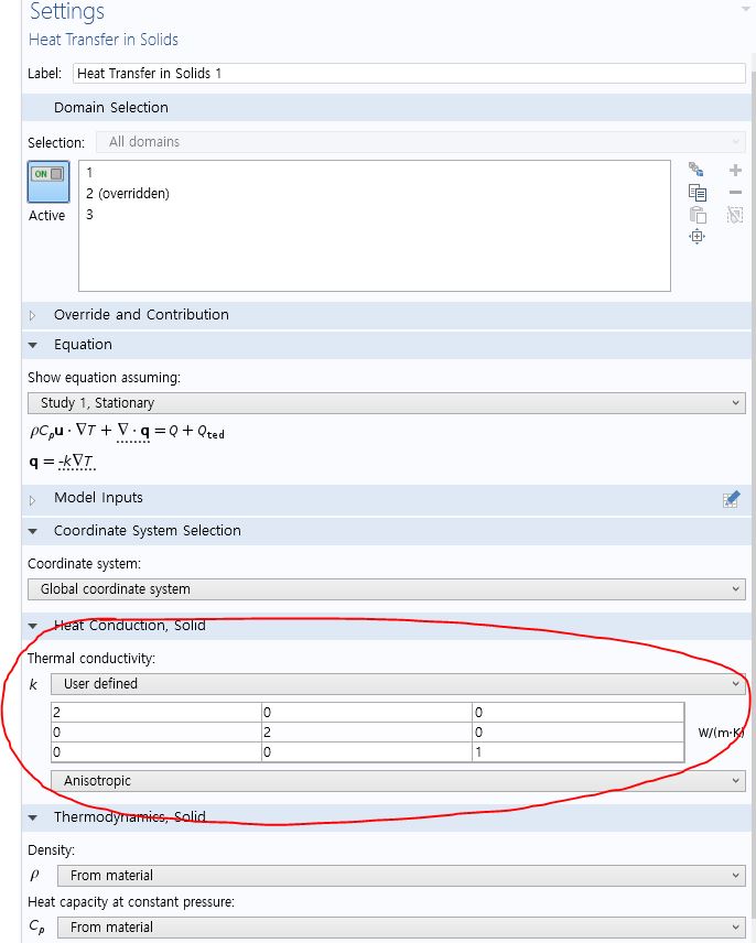

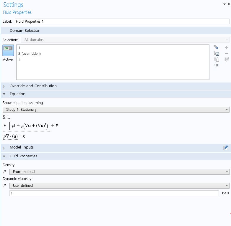

Unfortunately, dislike other physical modules, such as heat transfer (in attatched figure 'heat'), CFD module does not allow to use 'vector-form' anisotropic input variables (in attatched figure ' flow').
Could u suggest a good idea to solve this problem?
or recommend the other method to handle this?
I tried to build up stokes equation using 'coefficient PDE interface', but it is not easy to optimize and utilze the same as to results of CFD module..
