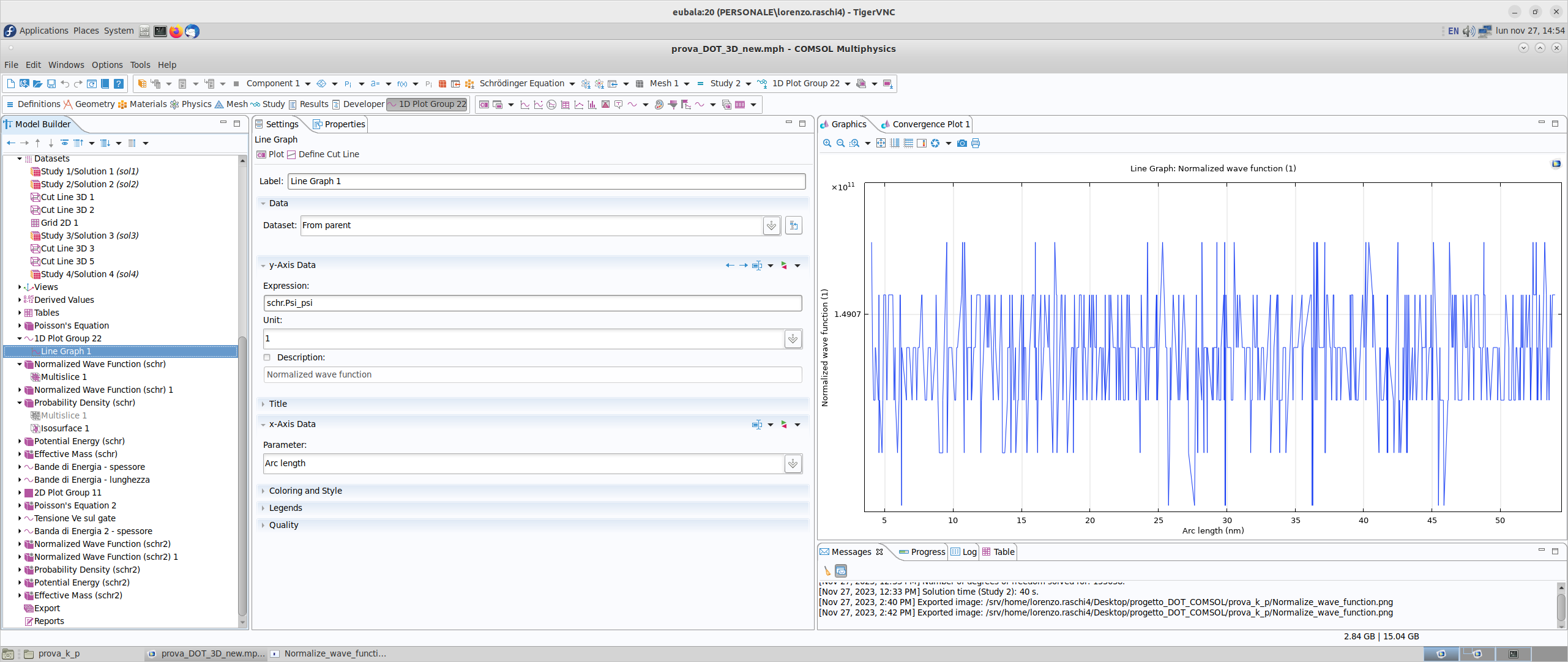

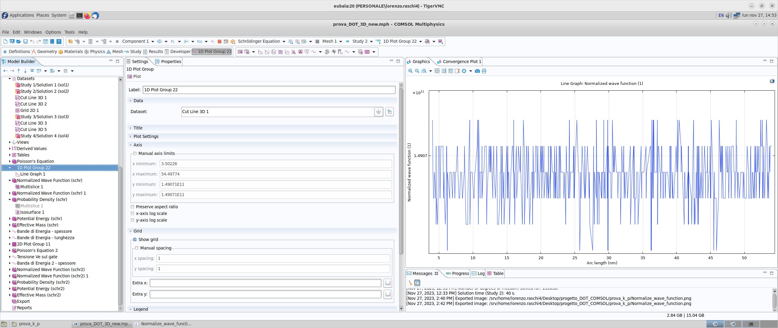

I am using Comsol Multiphysics but I have an issue with 1D plot.
I need to solve Schrodinger equation. I found the eigenvalues and the eigenfunctions, and now I want to plot the eigenfunction related to an eigenvalue on a cut-line. I calculated 6 eigenvalues. Below some images to explain the situation:

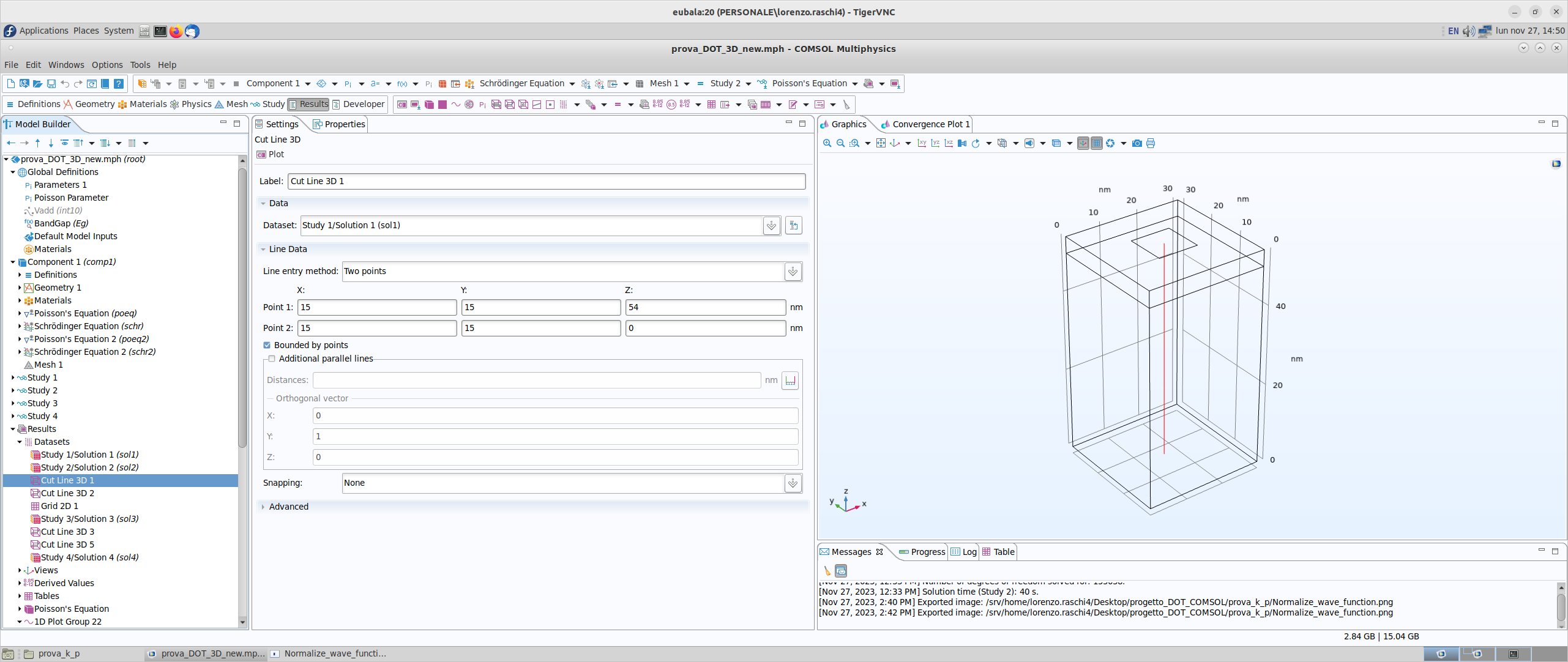

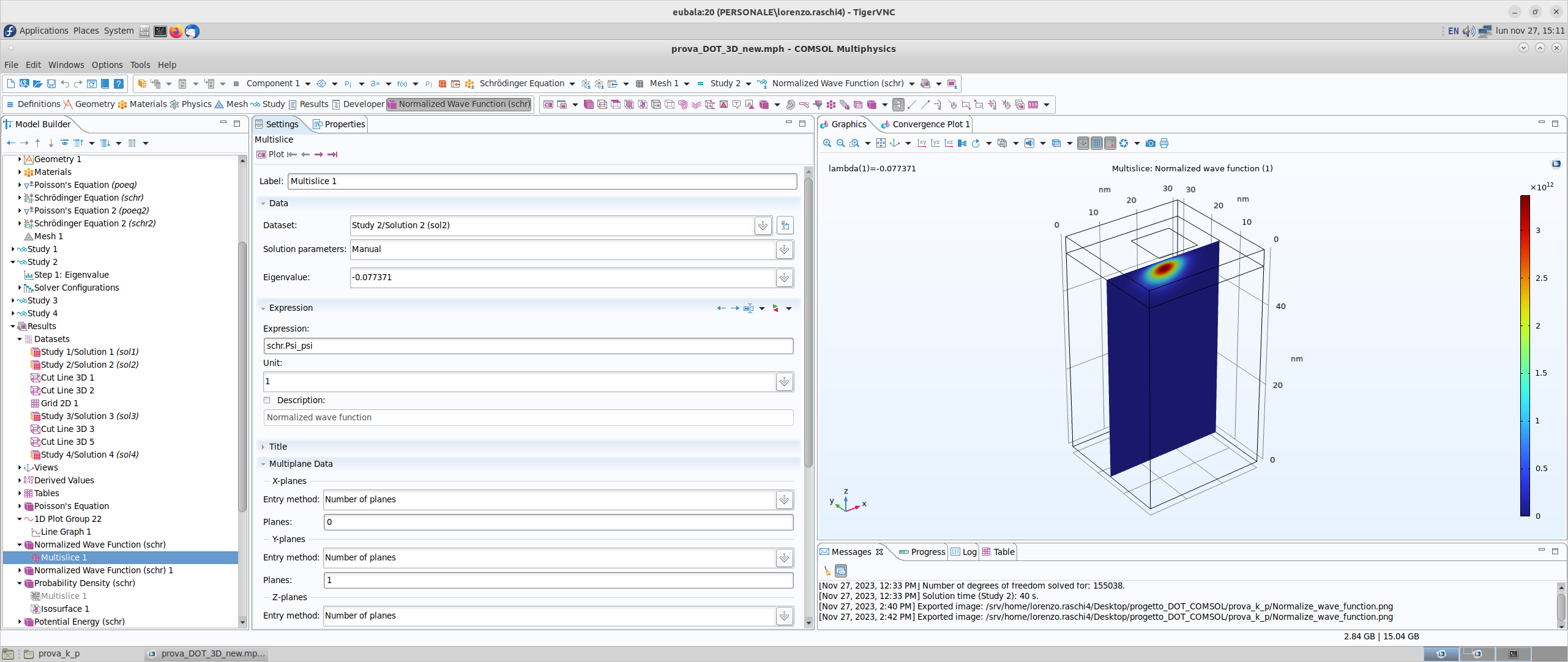

NormalizedWaveFunction image: I solved Shrodinger equation and I plotted on a plane. CutLine image: the cut line where I want to plot the 1D eigenfunction. 1DPlot1, 1DPlot2: These are the setup and the plot of the 1D eigenfunction.
First problem: I'm not able to choose the eigenvalue related to the eigenfunction I want to plot. Second problem: Assuming that I don't need to choose the eigenvalue, if I plot it the trend doesn't match what I see on the section plane.

From your screenshots, it appears that your multislice plot (which I understand you are happy with) is based on Study 2, whereas the cut line plots are based on Study 1. That could be the issue.
