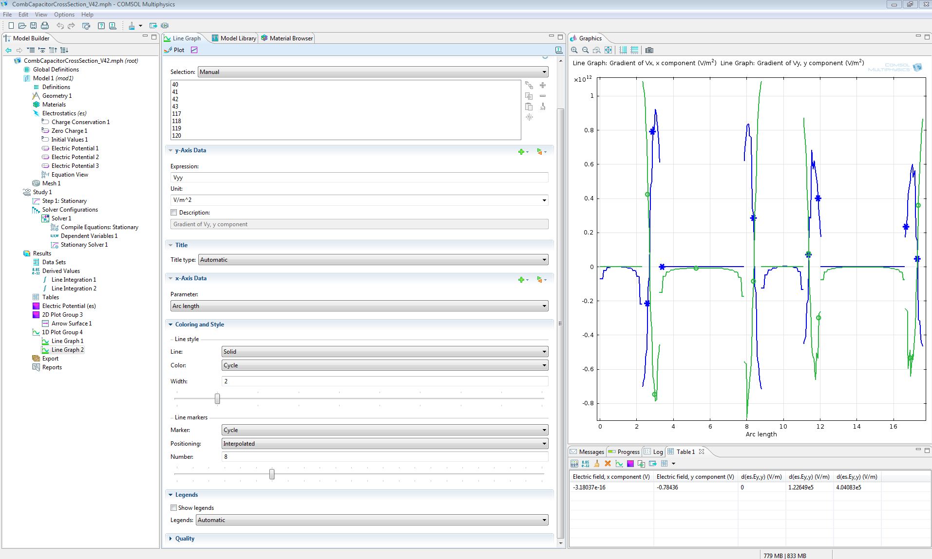

I am modeling a slice of a simple comb capacitor in 2D. I would like to determine the force acting on the fingers. I can calculate the electric field, but when I try to determine the force through Fy=dE/dy along the line it always returns zero. Please find the attached model.
I believe you should remake it fully fresh in latest V4 version, that would help.
Then note that Ex is -Vx=-dV/dx so your derivative d(es.Ex,y) = -Vxy.
This is already a second derivative of the dependent variable, you should increase the discretization to at least third order to get smoother derivatives. (and probably round off your sharp edges to minimise the edge singularities on the V gradients)
check the KB (knowledge base) about flux calculations

Here is an updated model using 4.2 and rounded edges. I still dont know how to calculate the forces acting on each line. I think it should be an integral if dE/dy (for Fy) but I always get zero. am I using the correct module?

in my 4.3.a I get non zero values (where you seem to get "0", strange), now you need to take the side parts too, ideally the full finger turn
But on the other side if you plot Vxx and Vyy along the entire loop around your "finger section" you get quite some spikes that will give you rather large errors see below.
I would propose to increase the discretization (turn on in the view mode) for V
One advise: use rather GND for the "0V" and a "Terminal" at 1V for the others BC's (instead of the Electric potential, as you have a scalar and not a field), then you get lumped parameters to compare already made up for you. But it should not change anything for your force calculation. And as you have only 1 domain, you cannot get the "ES Domain Force Calculation" defined
Do not forget these values are for a 1 meter loooong device (along Z)

that's good, by the way you were also missing a Force calculation on the domain, then you need to select the correct up/down (up for your case) tensor for the forces
turn on the equation view (preferences) and dig into the equations, its somewhere there-below ;)
