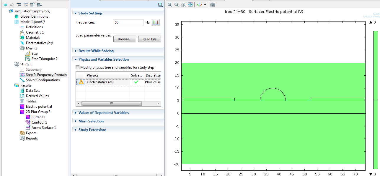

I'm currently studying the electromechanical effects of a water droplet under AC/DC voltages. The water droplet is placed between two rectangular electrodes. I've applied a electric potential to one of the electrodes and grounded the other.
I currently I have no issue simulating DC conditions in electrostatics, however when I simulate AC conditions I encounter a problem. I disable the stationary study and add frequency domain study. Leaving the magnitude in the electric potential, in the study settings I add a frequency of 50Hz. When I compute the simulation there is no electric potential or electric field.
Can someone help. Am I doing this process right or am I missing a step?

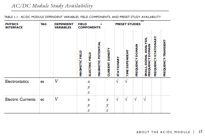

ES is not defined for frequency domain.
Ralf
I would answer yes and no ;) as ES does not allow for current flow, hence no resistance values, and no magnetic fields hence no true L inductance values, only pure capacitances. then the d/dt or omega^1 term can be dropped,
Then as you have C alone the d/dt^2 or omega^2 term can also be dropped. which means that even if frequency domain is not solved for, you can still do it without errors, whithin the hypothesis of ES

I tried running an AC simulation in EC and it worked no problem, however when I disabled frequency domain and ran a stationary study I got a singular matrix error and didn't know how to solve it. So I basically got fed up and created two files. One with ES stationary for DC simulations and one in EC with AC simulations.

I would say that is because there is no current flow in ES (static) so by default it's "isolated everywhere" those are the basic hypothesis of ES.
