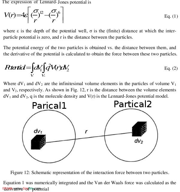

have you checked how to use the "dest()" operator on the different source and destination domains ?
I believe this is jut writing out plainvise your integration equation, no ?

Thank you! "dest" seems to be great!
But, one more question, when I use "integration coupling variable" in postprocessing, it appears only one CPU do work, actually I have 8 CPUs and use "-np 8 -64 ", however solving will, as expected, use all 8 CPUs. Is postprocessing can only use one CPU? Is there any way to work around it?
How about use PDE or ODE to tackle my problem?
